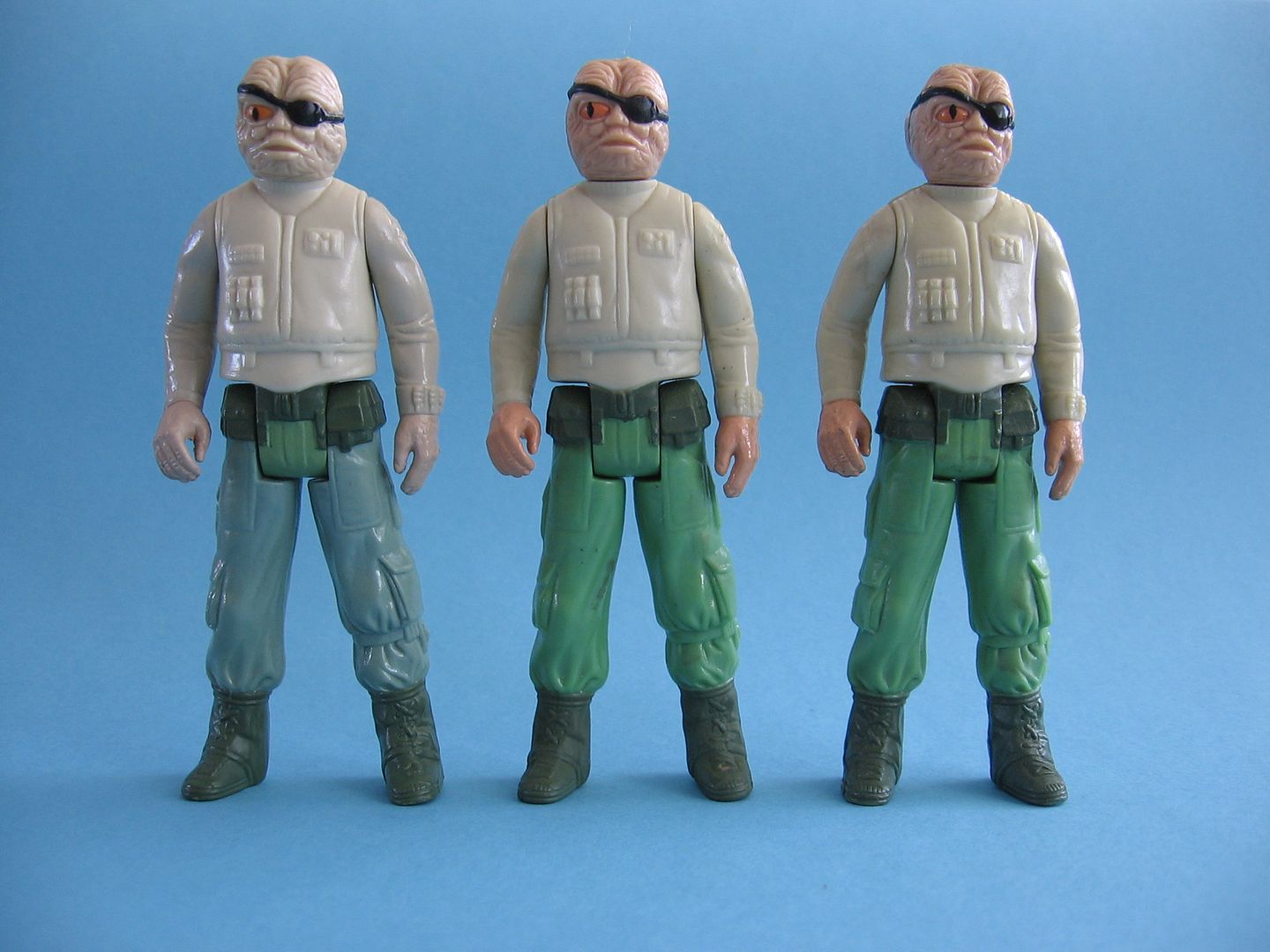

#2: Green Orange Purple Theory
Some paints can be composed of different pigments, e.g. Green (yelow+blue pigments), Orange (red+yellow pigments), Purple (red+blue pigments). You can imagine that degradation causes the relative amounts of the pigments in a paint to be changed, as one pigments degrades faster than the other.
Take for instance a look at the Prune Face at the left in the pic below. Suppose that the green paint within the plastic of the legs is composed of yellow and blue pigments. And that the yellow pigments have somehow degraded more over the course of time. We can then understand the two things which we actually see here: the green is shifted to blue (less yellow), and the colour is less intense (faded).
Green pants turning blue.
Everything You Always Wanted to Know About Discolored Figures But Were Afraid to Ask.  IMG_3638

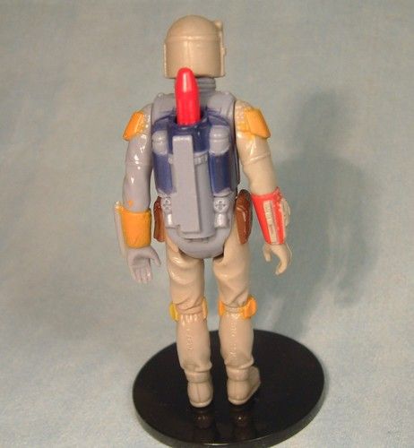

  • green (=yellow + blue) to blue: yellow fades away, blue remains (Prune Face blue pants)
  • orange (=red + yellow) to yellow: red fades away, yellow remains (Boba Fett yellow patches)
  • brown (= red + yellow + blue) to green: red fades away, yellow + blue = green remains  (Chewbacca green limbs, Yoda green snake)
  • dark blue to  light blue/grey: faded blue (faded Boba Fett limbs)

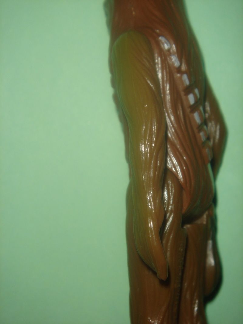

Now, how to explain the mixed limbs Chewbacca below?
Chewie: One Green and Brown Leg.
Everything You Always Wanted to Know About Discolored Figures But Were Afraid to Ask.  CHEWBACCAGreenLimbs
Simply. Very Happy. Different pigments in the brown paint mixed through the plastic are expected to have a different sensitivity towards degradation, resulting in a color shift during time (here brown to green as the red pigment decays). Assuming the same light exposure during time, the extent to which a pigment in the brown plastic was prone to degradation depended on the direct chemical ''environment'' which can accelerate degradation reactions and therefore makes things worse. Think for instance about the concentration of neighboring plastifiers, or flame retardants (producing free radicals, chemically highly reactive species) within the plastic. Different batches of plastic might have slightly different compositions, and therefore the colour shift might process at different speeds.
In case you would mix up the limbs from two different batches (which might be common practice in the Kenner factories) you could thus end up with the mixed green/brown limbed Chewie as shown in the pic.

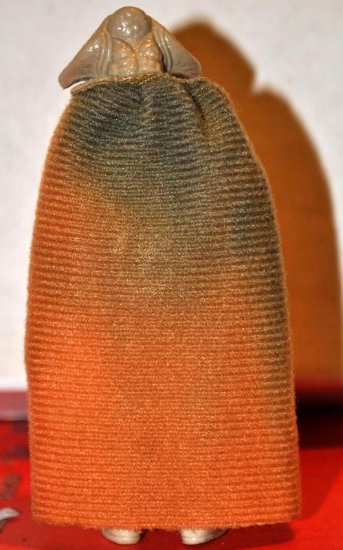

#3: Cyan Magenta Yellow Theory
The subtractive color theory explains the observed colour differences even better. This theory uses Cyan, Magenta, Yellow rather than Red, Yellow, Blue.

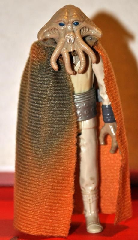

TIG member _Rog_ gave a few examples, discussed further in this thread:
- Ugnaught's cape: 'Neutral' coloured cloth dyed blue - magenta & cyan (1:1?). The cyan 'fades' leaving a magenta cape.
- Dengar painted torso: Dark purple made from magenta, some cyan and some yellow (2:1:1?). This time the magenta fades leaving the paint green.
- Luke / Rebel Soldier & Commander / Bossk painted legs & feet: Brown made from magenta, yellow & some cyan (something like 2:2:1 or 1:2:1?). Magenta fades leaving green again.

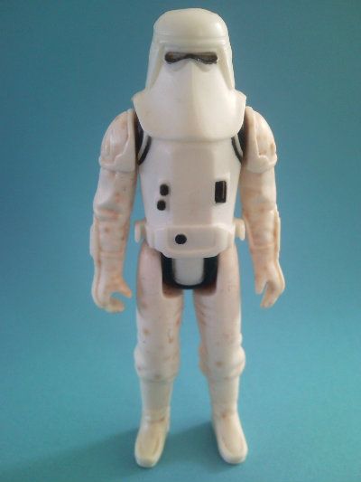

A SPECIAL TRANSFORMATION....BIOTRANSFORMATION!!!
Providing the right conditions (temperature, humidity) fungi/molds can use many organic stuffs as food, not only the bread and marmalade in your kitchen cabinet, but also more harsh materials like wood (think about the mushrooms in autumn forests), and as it seems even (horror!) plastics of your beloved Star Wars items.
Colonies of fungi can be observed as spots on Star Wars figures and give rise to a speckled appearance.
Fungi can be killed by bleach and UV but keep in mind that such treatment might also affect the plastics/pigments.
Moreover fungi have spent a few billion years longer on this planet than us and have successfully developed spores which are more resistant to antifungal treatments. Spores serve to spread the fungi to other areas and start a new life there. In this way fungi could in principle infect neighbouring figures. I sincerely hope this remains theory and won't happen in real life collections. To be sure I put the few molded figures in safe quarantine from the rest of my collection. Below is my childhood Snowtrooper affected by pinkish molds.
Biotransformant: my poor childhood Snowtrooper affected by fungi/molds.
Everything You Always Wanted to Know About Discolored Figures But Were Afraid to Ask.  28A_1-1

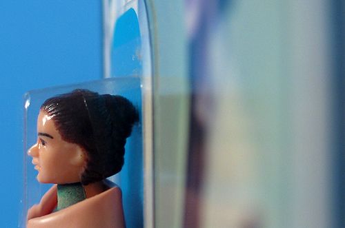

- Example 2 (a tougher one Very Happy): The green neck Leia Bespin. In this figure the metals in the applied gold paint reacted chemically over the years resulting in a green neck. In this case the green neck can be linked directly to the used gold paint, so you might argue, this is a true variant. But it is not IMO. Why? Cause the green neck Leia never left the factory in her current condition thirty years ago, so this figure is a transformant too. If you would have a gold neck Leia in your present collection, it would off course be a different story, that figure would be a true variant, as she represents the Leia that the factory intended to produce in the 80s.
Green neck Leia Bespin (source: Rebelscum.com)
Everything You Always Wanted to Know About Discolored Figures But Were Afraid to Ask.  LeiaBespin2

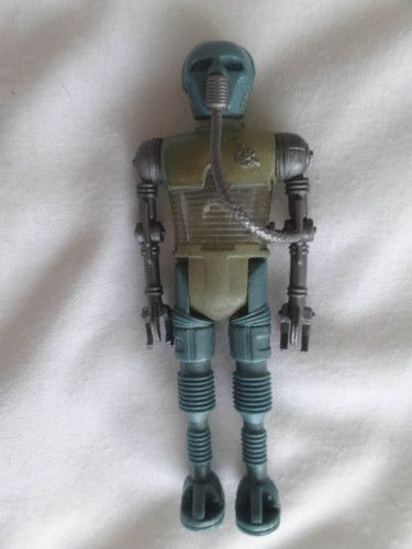

2-1B
Everything You Always Wanted to Know About Discolored Figures But Were Afraid to Ask.  Th_2-1B
#1: YELLOWED TORSO.

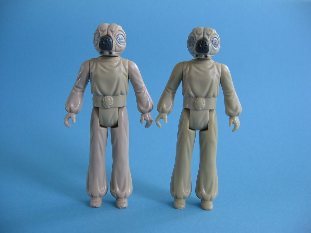

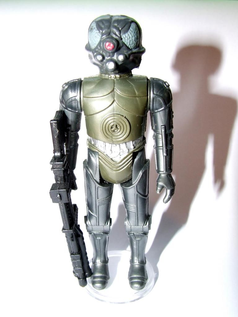

4-LOM
Everything You Always Wanted to Know About Discolored Figures But Were Afraid to Ask.  Th_4LOM2 Everything You Always Wanted to Know About Discolored Figures But Were Afraid to Ask.  Th_4LOM
#1,2: PINKISH ARMS AND LEGS (LEFT FIGURE).

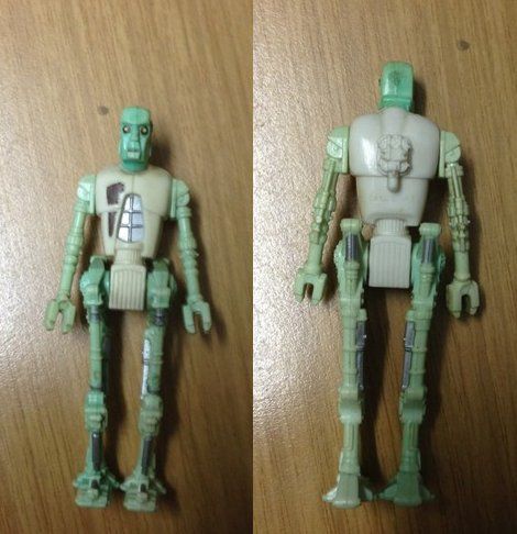

8D8
Everything You Always Wanted to Know About Discolored Figures But Were Afraid to Ask.  Th_8D8-1 Everything You Always Wanted to Know About Discolored Figures But Were Afraid to Ask.  Th_Transformant8D8
#1: YELLOWED TORSO.
#2: GREEN LIMBS AND HEAD.

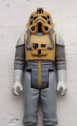

AT AT DRIVER
Everything You Always Wanted to Know About Discolored Figures But Were Afraid to Ask.  Th_ATATDriver3
#1: YELLOWED TORSO.

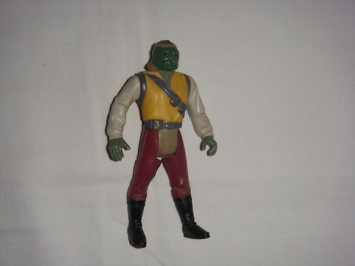

BARADA
Everything You Always Wanted to Know About Discolored Figures But Were Afraid to Ask.  Th_Barada_zpsfa47b88e
#1: YELLOWED PANTS.  Cool

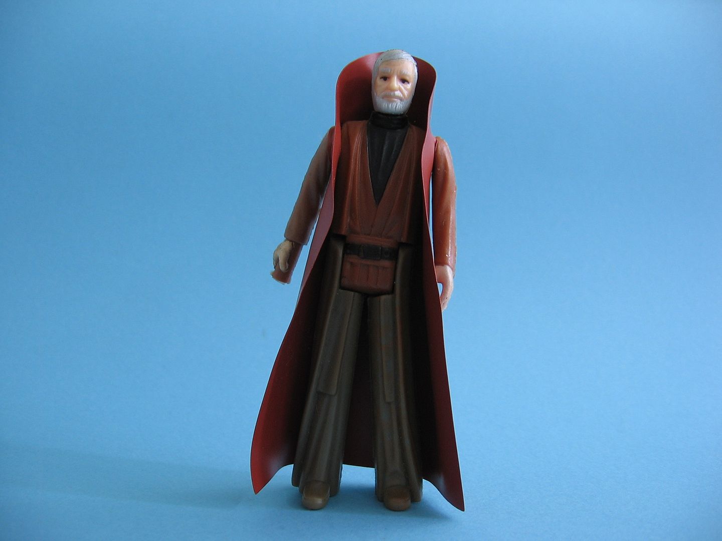

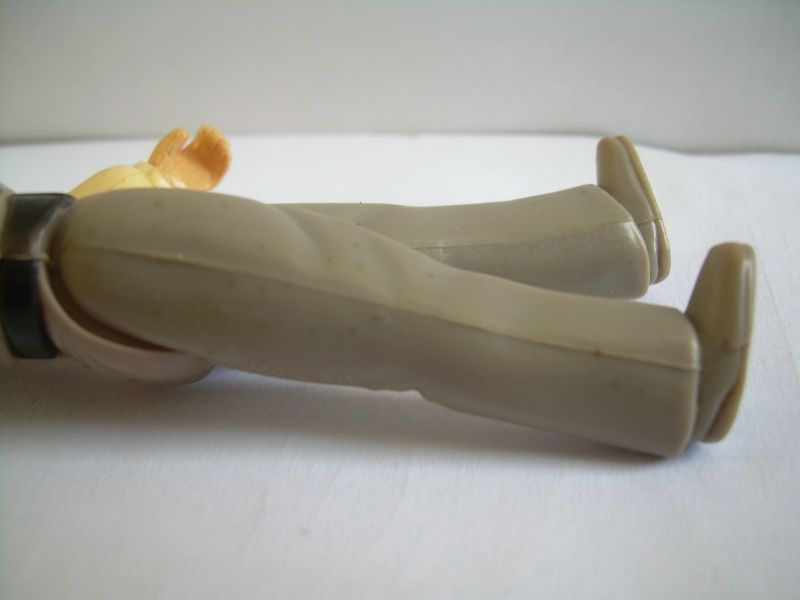

BEN KENOBI
Everything You Always Wanted to Know About Discolored Figures But Were Afraid to Ask.  Th_IMG_6923
#1: GREEN PANTS.

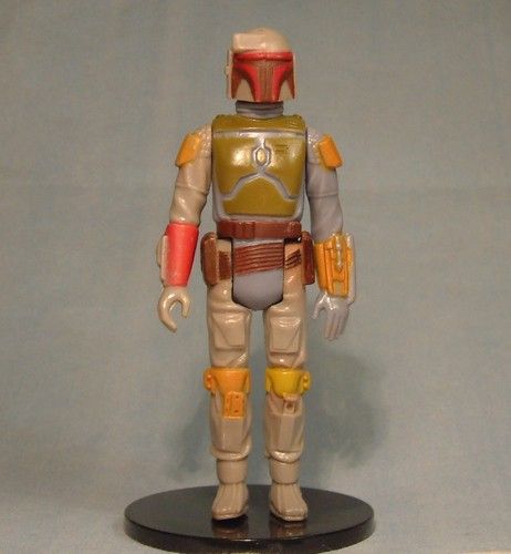

BOBA FETT
Everything You Always Wanted to Know About Discolored Figures But Were Afraid to Ask.  Th_TransformantBobaFett13Inch Everything You Always Wanted to Know About Discolored Figures But Were Afraid to Ask.  Th_TransformantBobaFett13Inch2Everything You Always Wanted to Know About Discolored Figures But Were Afraid to Ask.  Th_BobaFettEverything You Always Wanted to Know About Discolored Figures But Were Afraid to Ask.  Th_BobaFett2
#1,2: YELLOWED ARMS AND LEGS (13 INCH FIGURE).
#3,4: FADED HEAD AND LIMBS (BOTH LEGS AND ONE ARM).
CHEWBACCA
Everything You Always Wanted to Know About Discolored Figures But Were Afraid to Ask.  Th_IMG_6919 Everything You Always Wanted to Know About Discolored Figures But Were Afraid to Ask.  Th_Chewbacca3_zps602e238dEverything You Always Wanted to Know About Discolored Figures But Were Afraid to Ask.  Th_Chewbacca4_zps87b29433
#1: GREEN LIMBS.
#2,3: THE MISSING LINK: CHEWBACCA WITH LEFT ARM TURNING GREEN, HALF BROWN, HALF GREEN.

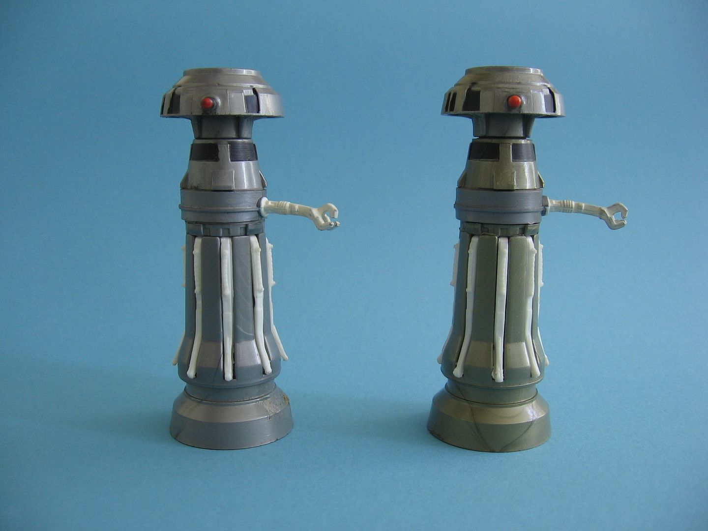

FX-7
Everything You Always Wanted to Know About Discolored Figures But Were Afraid to Ask.  Th_IMG_6918
#1: YELLOWED BODY ("GOLDIE"). (FIGURE ON THE RIGHT).

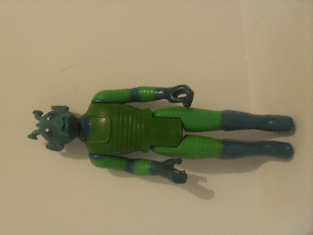

GREEDO
Everything You Always Wanted to Know About Discolored Figures But Were Afraid to Ask.  Th_Greedo
#1: DARK GREEN TORSO.

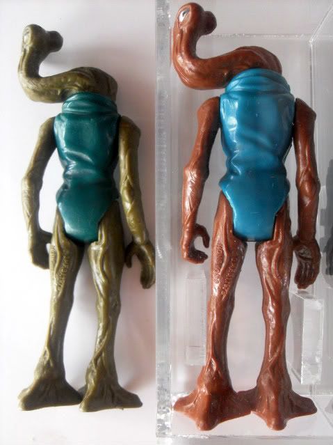

HAMMERHEAD
Everything You Always Wanted to Know About Discolored Figures But Were Afraid to Ask.  Th_HammerHead
#1: GREEN LIMBS.

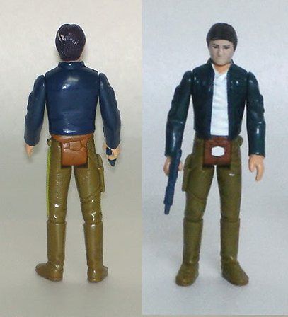

HAN SOLO BESPIN
Everything You Always Wanted to Know About Discolored Figures But Were Afraid to Ask.  Th_TransformantHanBespin
#1: GREEN PANTS.

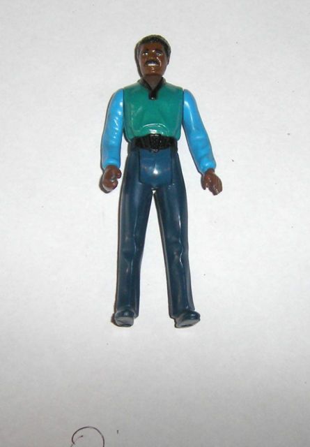

LANDO CALRISSIAN
Everything You Always Wanted to Know About Discolored Figures But Were Afraid to Ask.  Th_Lando-1
#1: YELLOWED TORSO, CAUSING A GREEN APPEARANCE IN COMBINATION WITH THE BLUE PAINT: YELLOW + BLUE = GREEN.

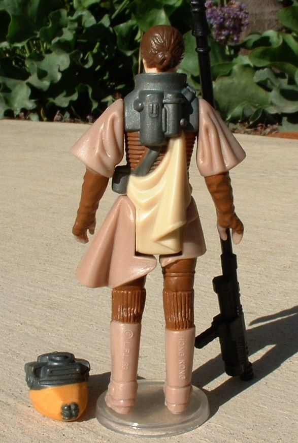

LEIA BOUSHH
Everything You Always Wanted to Know About Discolored Figures But Were Afraid to Ask.  Th_LeiaBoussh Everything You Always Wanted to Know About Discolored Figures But Were Afraid to Ask.  Th_LeiaBoussh2
#1,2: PINKISH ARMS AND LEGS.

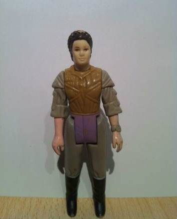

LEIA ENDOR
Everything You Always Wanted to Know About Discolored Figures But Were Afraid to Ask.  Th_LeiaEndor-1
#1: YELLOWED TORSO AND EVEN SOME PURPLE.

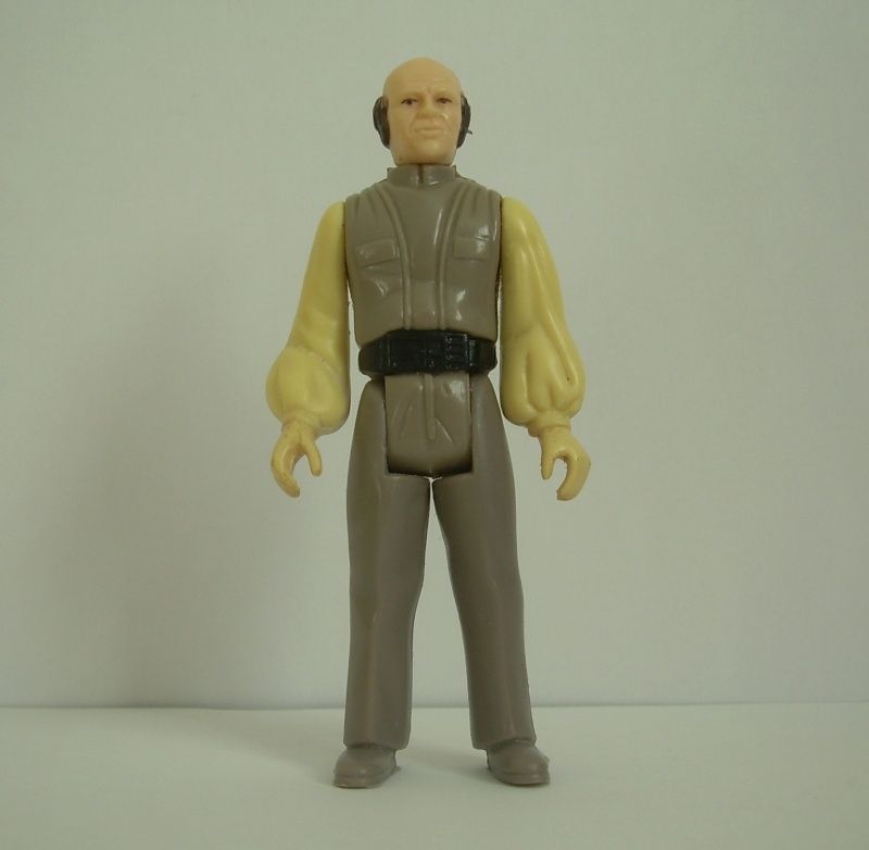

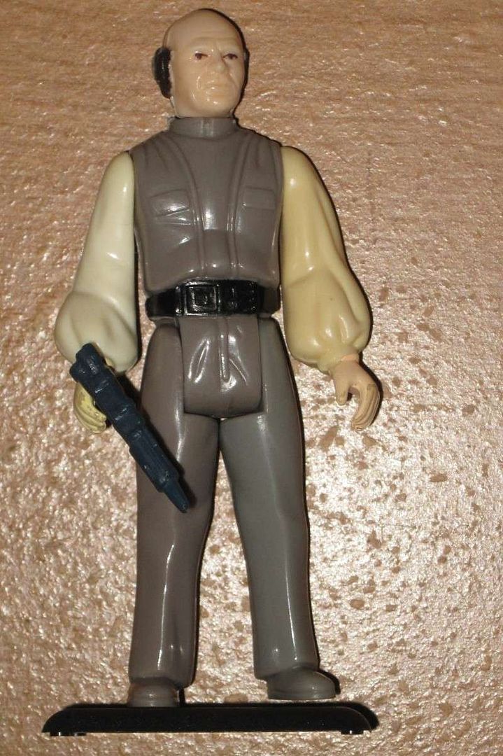

LOBOT
Everything You Always Wanted to Know About Discolored Figures But Were Afraid to Ask.  Th_TransformantLobot2 Everything You Always Wanted to Know About Discolored Figures But Were Afraid to Ask.  Th_TransformantLobot
Everything You Always Wanted to Know About Discolored Figures But Were Afraid to Ask.  Th_BioTransformantLobotEverything You Always Wanted to Know About Discolored Figures But Were Afraid to Ask.  Th_BioTransformantLobot2 Everything You Always Wanted to Know About Discolored Figures But Were Afraid to Ask.  Th_BioTransformantLobot3
Everything You Always Wanted to Know About Discolored Figures But Were Afraid to Ask.  Th_LobotWhiteArm
#1,2: PALE HANDS (WERE PINK WHEN THEY LEFT THE FACTORY, SEE CLOSE-UP)
#3,4,5: BIOTRANSFORMANT HAVING MOULDS ON HEAD AND LIMBS
#6: WHITE ARM (PROBABLY DUE TO MIX UP OF ARMS MADE OUT OF GOOD AND BAD QUALITY PLASTIC, THE BAD PLASTIC HAS DEGRADED DURING TIME)

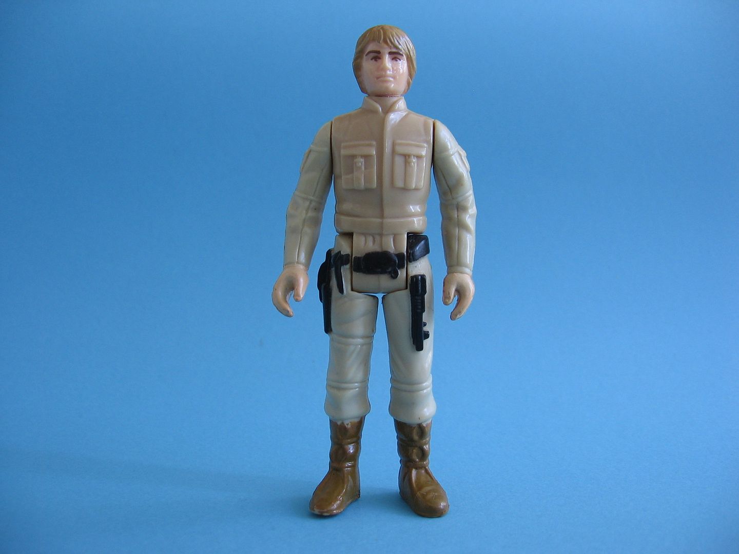

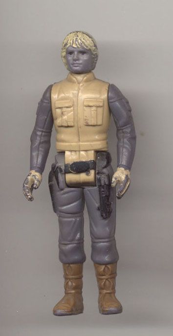

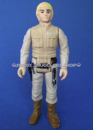

LUKE BESPIN
Everything You Always Wanted to Know About Discolored Figures But Were Afraid to Ask.  Th_LukeBespin-1 Everything You Always Wanted to Know About Discolored Figures But Were Afraid to Ask.  Th_LukeBespin2Everything You Always Wanted to Know About Discolored Figures But Were Afraid to Ask.  Th_IMG_6926Everything You Always Wanted to Know About Discolored Figures But Were Afraid to Ask.  Th_LukeBespin3
#1: GREEN BOOTS.
#2: PURPLE ARMS, LEGS, AND HEAD. PROBABLY SPENT TOO MUCH TIME WITH THE LEIA ENDOR ABOVE. smoke
#3,4: PALE ARMS AND LEGS.

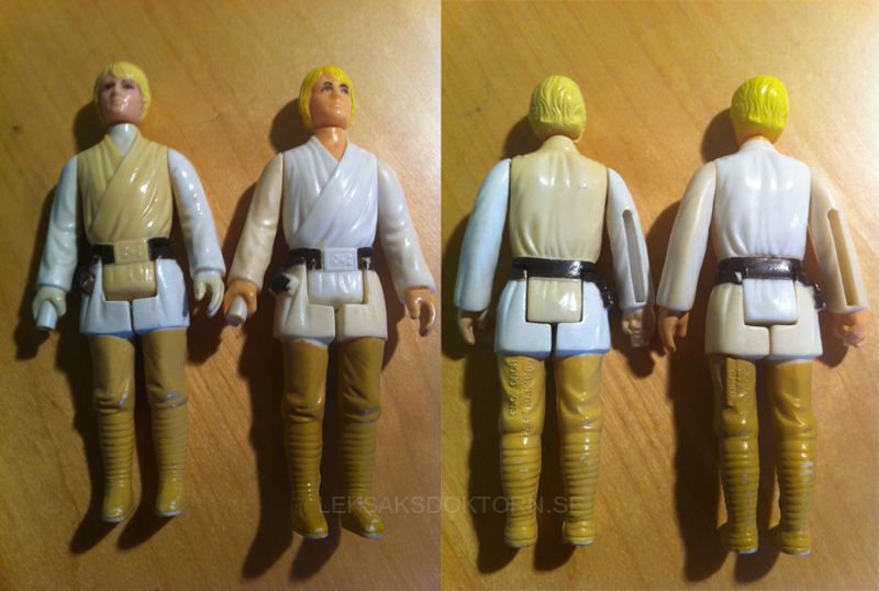

LUKE FARMBOY
Everything You Always Wanted to Know About Discolored Figures But Were Afraid to Ask.  Th_LukeFarmboy   Everything You Always Wanted to Know About Discolored Figures But Were Afraid to Ask.  Th_LukeFarmboy2
#1: PALE HEAD.
#2: PALE HANDS AND NECK. YELLOWED TORSO.

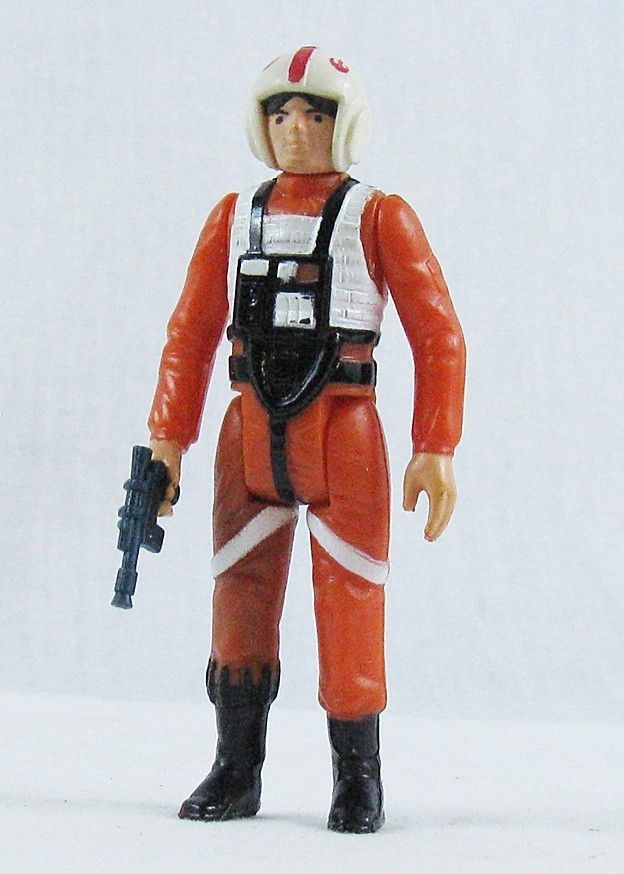

LUKE X-WING PILOT
Everything You Always Wanted to Know About Discolored Figures But Were Afraid to Ask.  Th_TransformantLukeXWing Everything You Always Wanted to Know About Discolored Figures But Were Afraid to Ask.  Th_LukeX-Wing_zpsc5290957
#1: DARK RED ARMS AND LEGS (''LUKE B-WING PILOT" Very Happy).
#2: DARK RED RIGHT LEG.

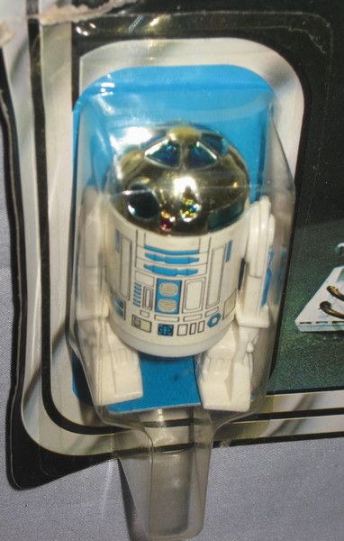

R2D2
Everything You Always Wanted to Know About Discolored Figures But Were Afraid to Ask.  Th_R2D2-1   Everything You Always Wanted to Know About Discolored Figures But Were Afraid to Ask.  Th_R2D2GoldenDome
#1: GREEN DOME (FIGURE ON THE LEFT).
#2: GOLDEN DOME.

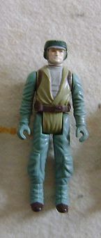

REBEL COMMANDO

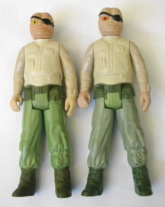

Everything You Always Wanted to Know About Discolored Figures But Were Afraid to Ask.  Th_TransformantRebelCommander
#1: GREEN ARMS AND PANTS.
REBEL SOLDIER
Everything You Always Wanted to Know About Discolored Figures But Were Afraid to Ask.  Th_RebelSoldier
#1: YELLOWED ARMS.

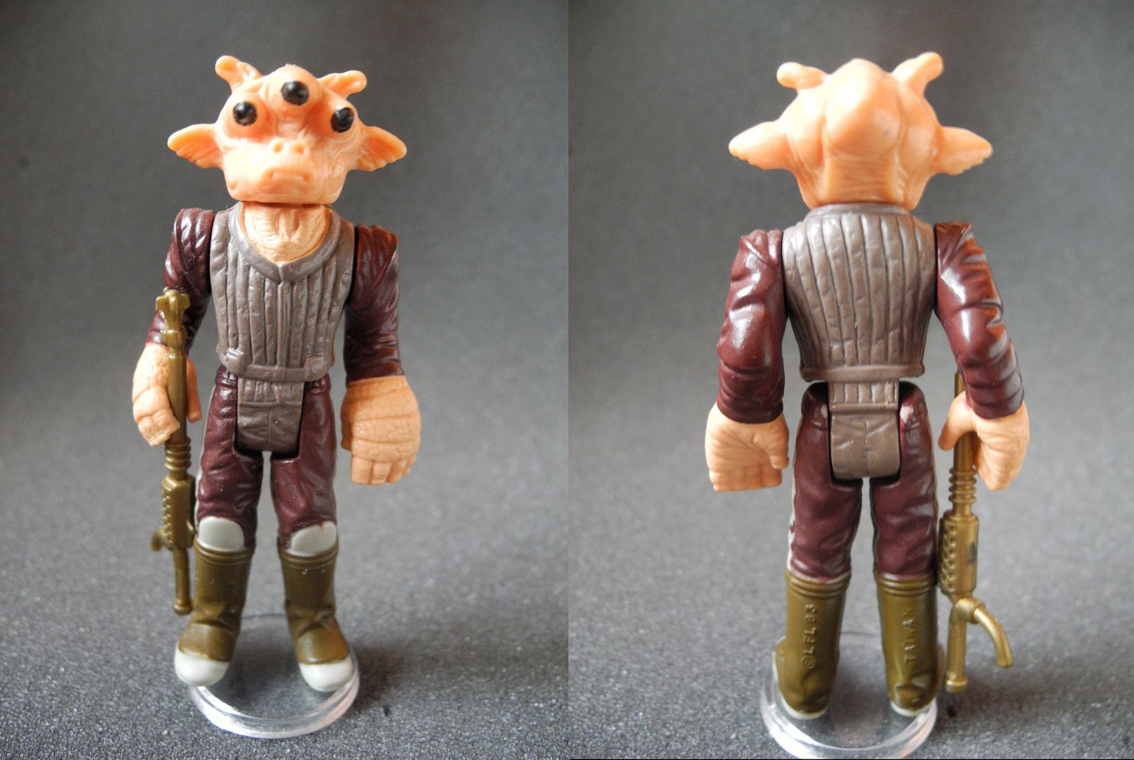

REEYEES
Everything You Always Wanted to Know About Discolored Figures But Were Afraid to Ask.  Th_ReeYees Everything You Always Wanted to Know About Discolored Figures But Were Afraid to Ask.  Th_TransformantReeYees
#1: GREEN DISCO BOOTS.
#2: GRAY TORSO.

ZUCKUSS
Everything You Always Wanted to Know About Discolored Figures But Were Afraid to Ask.  Th_Zuckuss_zps2405a46e
#1: GOLDEN (YELLOWED) TORSO.

SQUID HEAD ORANGE CAPE
Everything You Always Wanted to Know About Discolored Figures But Were Afraid to Ask.  Th_SquidHeadEverything You Always Wanted to Know About Discolored Figures But Were Afraid to Ask.  Th_SquidHead2

- Hammerhead green limbs
http://forum.rebelscum.com/t1025675/

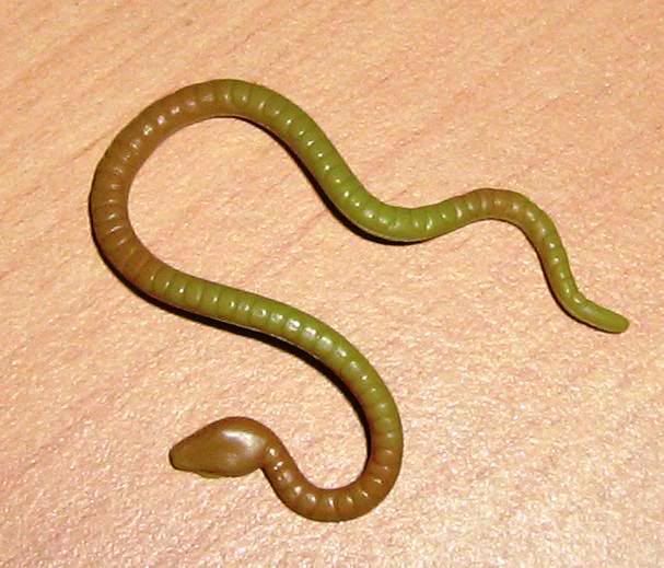

”The missing link”: Brown snake turning into a green one.
Everything You Always Wanted to Know About Discolored Figures But Were Afraid to Ask.  MissingLinkYodabrowntogreen

The one in the middel and the one on the right are made from a differnt material compared to the left one!!!
The right one is clearly discolored! But whats with the one in the middle??? He starts to discolor on the outer parts, but was this smock ever bright blue over all like the left one??? I dont think so...and nobody could have proven me till today that this kind of fabric ever was blue!
So Im generally against all this noob questions and these very straining threads with dicolorations which are no variants, but I think its also important to see the differences on materials while comparing and to check and research the history! The second fabric never appeared in bright blue! Thats a fact...so please tell me if Im wrong....but I dont think so!

You are right Scott! Three figs with 3 different coos. From left to right:
1/
left leg (2 lines)
(c) 1980 L.F.L
HONGKONG
2/
left leg (2 lines)
(c) L.F.L
1980
right leg (2 lines)
Made in
Hong Kong
3/
Left leg (1 line)
(c) 1980 L.F.L
Right leg (2 lines)
Made in
Hong Kong
So it might ben then real variations and not a discoloration, thanks Scott for the hint!
It is definitely a variant mate as it has a unique COO, the only way you'll know if its discoloured is to compare it to another figure with the exact same COO. It could still be discoloured though but It's still a variant.
Wolf, Thats a great post for me mate, please keep going.

Thats definatley dangerous mate! A different coos doesnt say its a variant. Remember lots of steelmolds went together and can be stamped individually. Another coo doesnt mean another place of manufacture!
Ill check my ugnaughts when I have the time! There is indeed a few different haircolors...but nevertheless....BTT!

In my eyes it's a variant mate, even if its made at the same factory but with a different mold or newly stamped mold, as that produces a unique COO.
