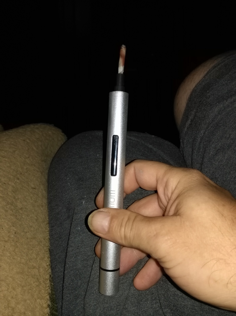

I even got this really cool skinny barrel end lighting precision screwdriver...
LrdSatyr's Star Destroyer Build (PIC HEAVY) Zisd-w10

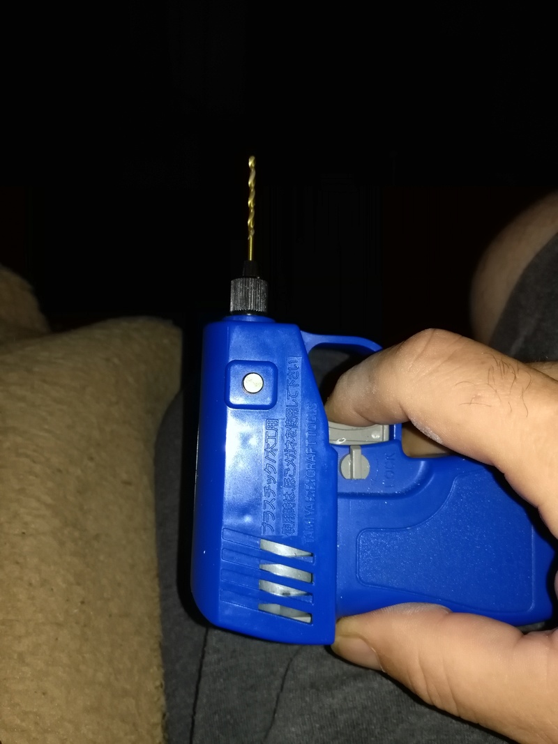

But for some reason, I always end up going back to my old AMT Micro Drill
LrdSatyr's Star Destroyer Build (PIC HEAVY) Zisd-m11
LrdSatyr's Star Destroyer Build (PIC HEAVY) Zisd-m10
However, the bits are hard to find for them anymore since they don't make them anymore.  So that means I would would have to make my own (see method above LOL).  First I made myself a few drill bits.  Wanting to play with my 3D printer I actually made a few bit holders that printed up awesomely!  I'm now ready to start drilling my holes!  Time to prep the model for drilling... More to come!

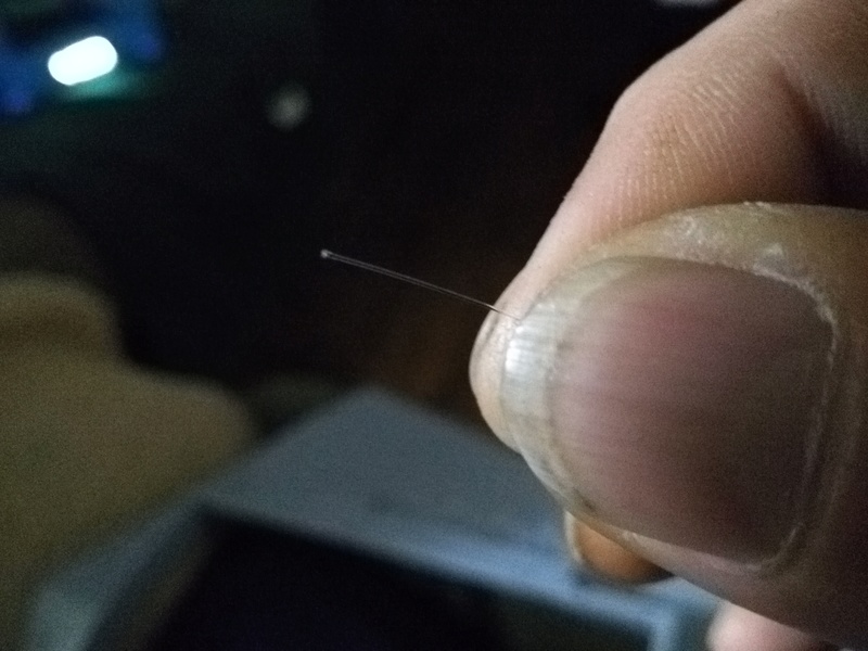

I'm using 64 strand fiber cable. Basically what that is is a bundle of .25mm fiber strands all bundled together in a single cable (kinda like a multistrand wire) and surrounded by a dark plastic sheath coating.  With this cable I have to strip the plastic sheath coating off the cable to get to the fibers, it's a pain, but its worth it!   Now one you have a single fiber, you hold the end of it near a heat source... I don't like to use open flame, so I use a cigarette.  I move the end near the heat of the cig but don't actually touch it.  What happens is the end will melt slightly and form a mushroom type head on the end.
LrdSatyr's Star Destroyer Build (PIC HEAVY) Zisd-f15
This is very important.  It's tedious but it has to be done with every fiber I'm using.  Some model builders skip this step and just glue the fiber in the hole with a little bit of it hanging out.  Then they paint and snip that little end off close to the surface so that it looks like a window.  Personally I prefer mushrooming because it makes things so much easier as you progress.

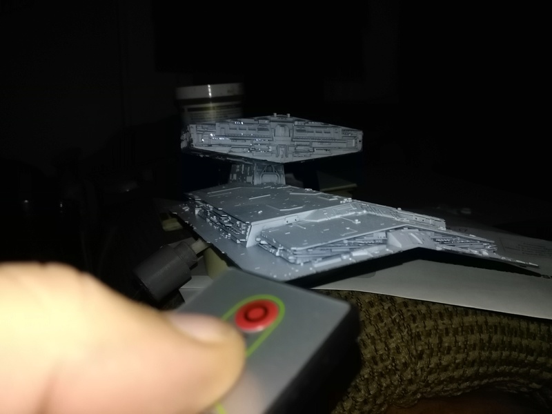

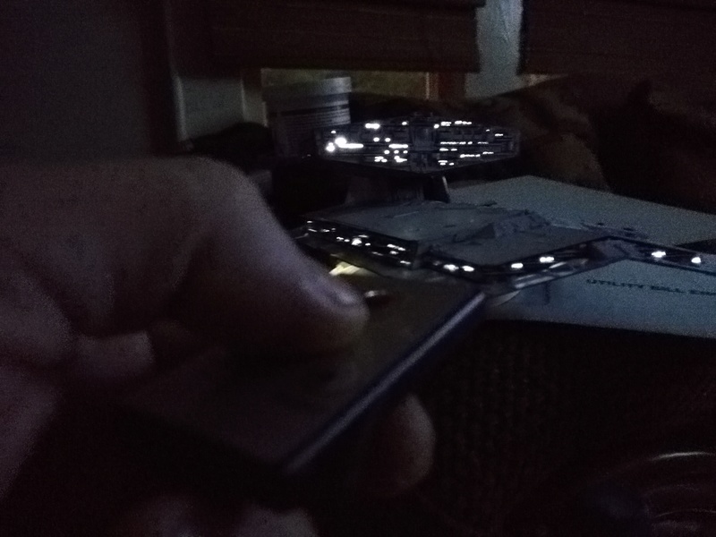

Well I started putting fibers in... I began by putting in the fibers on the front lower hull... god there are alot of lights on this thing!
LrdSatyr's Star Destroyer Build (PIC HEAVY) Zisd-f16
Then I started putting fibers on the back of the upper tier sections...
LrdSatyr's Star Destroyer Build (PIC HEAVY) Zisd-r10
Then I was sitting there after about 3 hours of this and realized that I was gonna have to paint this puppy first!  Oops!  So after smacking myself in the head, I pulled all the fibers out that I had just put in... Why?  Well if I put the fibers in now and paint afterward, I'll cover all the little lights with paint and then I'd have to go and scrape the paint off every little fiber end to allow the light to shine thru... so, after ripping out all the fibers I HAD JUST PUT IN, I painted the whole thing flat black! You'll see why soon!
LrdSatyr's Star Destroyer Build (PIC HEAVY) Zisd-b11

Took a break last night on the fibering to do a little work on the electronics.  One thing I wanted to do was create a simple method of connecting and bunching my fibers so that it was easier to take them apart if need be.  Shrink Tube just doesn't work well if you have to take something apart and you really don't want to do any damage to the fibers themselves.  So I fired up my 3D Printer and came up with these...
LrdSatyr's Star Destroyer Build (PIC HEAVY) Zisd-310
LrdSatyr's Star Destroyer Build (PIC HEAVY) Zisd-311
My idea... fit the fibers in the tube and glue them in securely, trim the ends off and then fit a LED at the bottom of the barrel.  Put the tube in the barrel and whala... instant fiber connection that can come apart if I need to!
LrdSatyr's Star Destroyer Build (PIC HEAVY) Zisd-312
One thing I just can't express enough joy about are the kits available from Evans Designs.  I've been getting my LEDs exclusively from them for the past 15 years now and I have yet ever has a problem with anything I've gotten from them.  They've got not only just about every kind of LED available (every size, shape, flashing, flickering, etc) all prewired and preresistored so you don't have to worry about if it'll work or not, but they also have a bunch of cool switches, power supplies, and even fiber optics, but by far, the coolest thing they carry are these cool little Remote Control kits...
LrdSatyr's Star Destroyer Build (PIC HEAVY) Zisd-r11
LrdSatyr's Star Destroyer Build (PIC HEAVY) Zisd-r12
and it's so simple.  It is just a couple of wires attached to a sensor with a remote control.  Attach red to red and black to black and you're done.  Really simple and a no brainer!  Couldn't get any easier than this!  Did I mention, it also has a built-in dimmer so you can actually make the light brighter or dimmer with the remote... how sweet is that?  Now here's the best part... they are only $10.00!  Yeah... that's right!  You can get them here:
http://www.modeltrainsoftware.com/led-remote-control.html
So I hooked everything up, used a spare LED I had (this is not the correct color, but it'll do for testing, plugged in a 9V battery, and tried out my new remote.
LrdSatyr's Star Destroyer Build (PIC HEAVY) Zisd-t16
LrdSatyr's Star Destroyer Build (PIC HEAVY) Zisd-t17
Flawless!  This is coming together sooooooooooo sweetly!  More to come... stay tuned!
